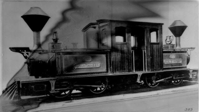

For those of you who don't know me I am 14 years old and since school got out in May, I have been scratch building a 0-4+4-0 fairlie locomotive. The prototype was purchased by the Denver & Rio Grande in 1873. It was built in England by the Vulcan Foundry Co. and named the 'Mountaineer". There are two known photos of her, one a builder photo in England, and the other somewhere on La Veta Pass between La Veta and Alamosa, Colorado. She was #101 and the first articulated engine ever to run in Colorado.Supposedly she was less than successful because they junked her in 1883 and scrapped her in 1887. She was a helper on La Veta most of the time to help trains up the 4% grade. The problem was that one set of drivers would pull the bulk of the train while the other set just spun randomly.
Here is the builder's photo taken at the Vulcan Foundry...
