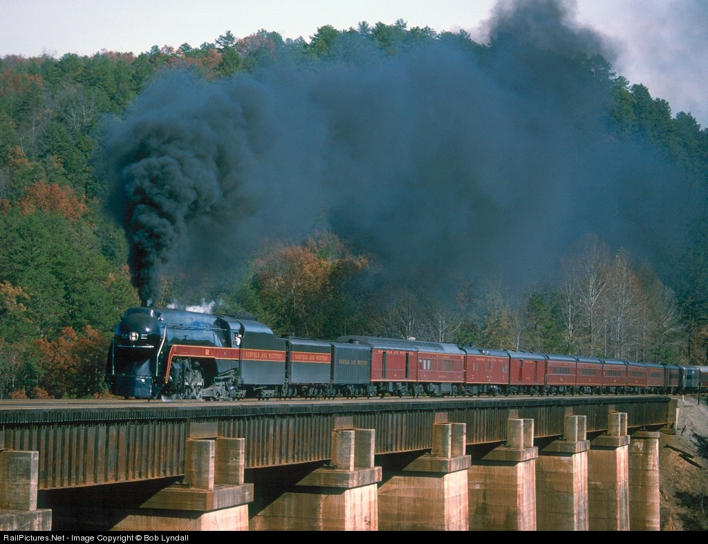

Garrett,
Museum engines are always over-glossed and kept way to spotless. The real things to look at are locomotives doing long cross-state railfan trips, like the 3751 through the desert on it's way to the grand canyon.
Engines always collected a gathering of calcium streaks (hard water), dirt/dust, and oil stains/soot from the fire.
