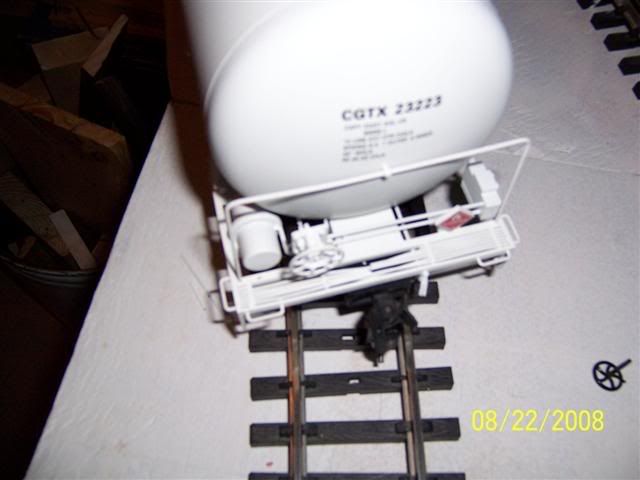

I've also purchased their modern tanker and noticed something today. I see the plastic end platform has broke. It appears to have expanded? It has just been sitting with no temp changes in the basement and nothing striking it?
