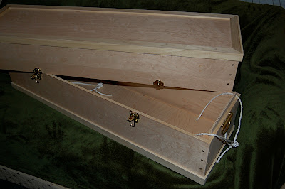

The Garratt doesn't have a chance of fitting in any toolbox I've found.  A relative built a custom box for me, and has built another for a friend.  The top is held on with 4 latches, staggered so it only fits one way.  The loco has a lift-out cradle in the box.  I've also lined it with the above foam.
(click the photos for full size images)
I wouldn't ship any of my cases, but they seem more than adequate for driving to steamups.
