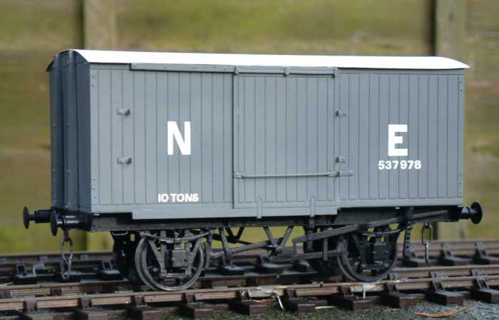

The kits in mind are for small wagons freight rolling stock kits (Goods vans, 5 or 7 plank open wagons, etc.) Wagons typical of 1:19 or 1:32 UK, Europe, Austrialan, etc. railways. From the look at the kit parts on web sites the body is etched brass and the under carriage parts are white metal, some in brass (and wheels).
Directions say they can be built with glue or low temp solder. What works better?

In theory it should handle the white-metal-to-brass joints without destroying the white metal (like the axleboxes on that wooden wagon on the last photo. In practice, I'd try it first on a piece of scrap!

Interesting about that last wagon, here is its description:
"13 Ton end door china clay wagon:
This kit has 3 thickness' of brass to simulate detail on the interior as well as on the exterior plus the correct 'plank' thickness"
Great looking wagon and no wood. I think I would get a bunch of them, polish the brass and lacquer them. Not very prototypical but they shure would be pert'tee.
Agree, try it first - particularly in my case! /DesktopModules/NTForums/themes/mls/emoticons/hehe.gif /DesktopModules/NTForums/themes/mls/emoticons/whistling.gif
