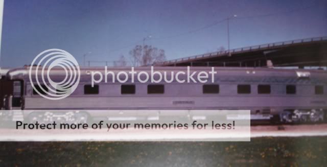

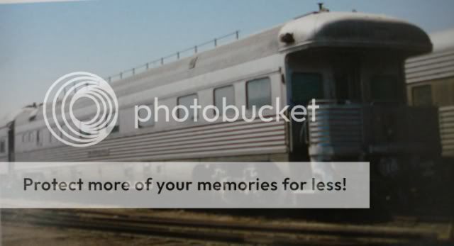

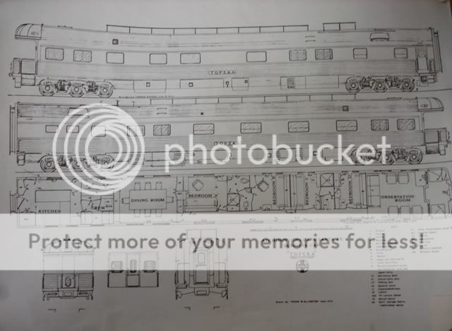

My latest projects are the Santa Fe business cars; Atchison, Topeka, and Santa Fe. A friend of mine has always wanted to model these cars and so I thought I would look into it for him. I am planning on building these business cars from USA Trains sleepers. I am also going to use resin casting so that I can make duplicates easily.
Below are some pictures of the cars and some interior blueprints. I do not know a great deal of history behind these cars, so if anyone would like to share some history or photos, I would love to hear from you.
I will try to update pictures of the project as much as I can. I will not have a great deal of time to work on this project until Christmas break however. If you have any ideas or suggestions, please don’t hesitate to tell me. Michael

Not sure if you know this already, but the Santa Fe and Topeka were Budd built while the Atchison was a Pullman car. Santa Fe and Topeka rode on 6 wheel trucks, while the Atchison rode on 4 wheel wheel trucks. Might be hard to do the Santa Fe or Topeka with a USA car because of the trucks. The Atchison had 2 large windows at the observation end which could also be an issue to model. Before the Topeka and Santa Fe were built, the Atchison used to be named Santa Fe.

I have that book on order from the SFRH&MS, but until it arrives, I might take you up on your offer. As for the trucks on Santa Fe and Topeka, I am thinking about heavily modifying the AristoCraft commonwealth truck. Then I will use resin casting to make duplicates. As for Atchison, I am not going to bother with the windows. I just can’t see making perfect cuts in the aluminum frame. With that said, I am looking forward to this project!
