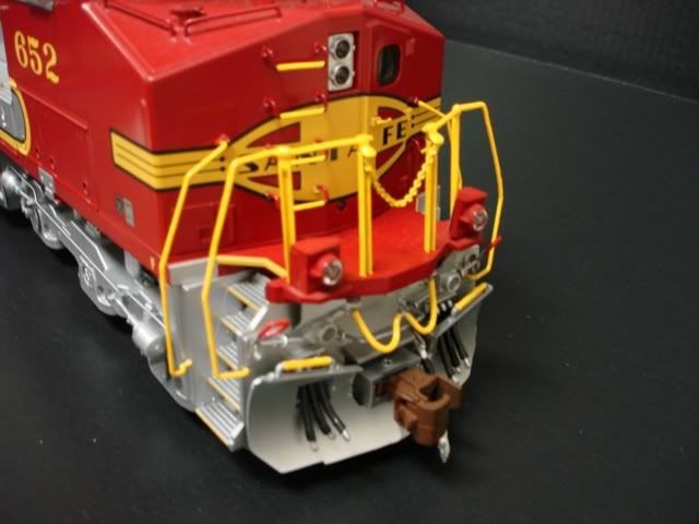

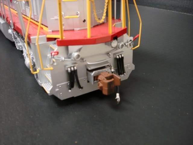

Here is a picture showing shrink tubing.
I cut the plastic air hoses that came with the model and put shrink tuning that just fit on the plastic stub. I shrunk only the part over the plastic stub. That way, the center of the hose is not unusually small. You can actually bend the hoses. I did this to the MU hoses and the train line hose.
