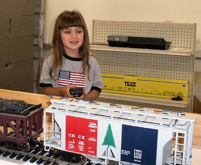

You can chop the workings out of most any RC toy and put them to use. Otherwise, I'd go for an Aristo Basic. She'll figure out how to use it pretty quick.
Trinity here is 4. That's an Aristo Trackside unit.
