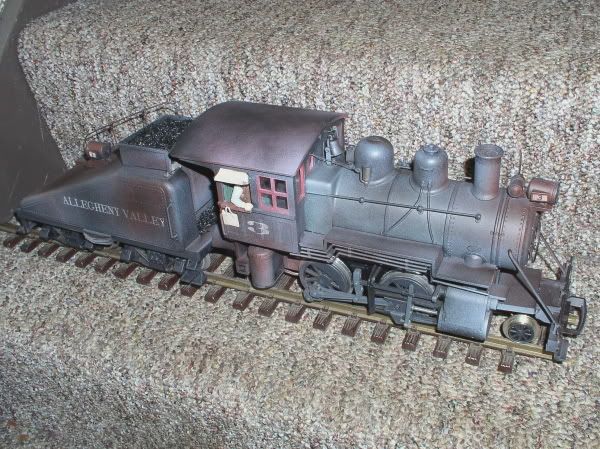

The last two evenings were spent on this beast. Kim saw me do it, but doesn't know it's HERS....
" align="absmiddle" border="0" />
Yes, it's "just" an old beat up Aristo 0-4-0 that I got off evilbay a while back-- with a few little mods. Since the Aristo was the "wrong "scale I started with the cab, which is one of those Delton c-16 cabs I had. The pony truck is off who knows what, it came from ebay as well. The pilot was snapped off flush with the front of the loco so I extended it with some brass soldered together and held in place with 2 screws. The engineer is a modified Just Plain Folk figure. He had one arm up in the air, so he's blowing the whistle. The fireman is one that came with an LGB mogul I sold off a while back with a B'mann shovel. The backhead on these things are kind of sparse, I made a water column with 2 picture nails and a bit of brass wire, added a tray with an oil can and scratchbuilt a firebox door out of styrene. I may add more later if I an find a decent picture. I used some Ozark Miniatures and Trackside Details castings I had in the scrap box, and the bell is a modified tinplate Lionel standard gauge tinplate reproduction with a handmade yoke.The sun shades are wire and painted paper. The tender has a modernized, lowered back up light, and a larger coal bunker. While I was at it I electrically connected the pony truck and the tender pickup to the loco as well. Paint WAS my usual modified GN glacier scheme with forest green boiler jacket, grey smokebox, Brunswick green cab and tender, and barn red roof...even though it IS kind of hard to tell that now.
Decals are from Stan Cedarleaf. I need to add the chains from the tender frame to the trucks and air lines yet.
The consist will be 3 Kalamazoo passenger cars done in B&O royal blue with grey trim grey.
