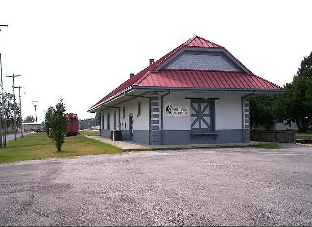

As some of you may recall, among the 7956 other projects I have underway, I am building a replica old the old GM&O/ICG depot in Sparta Illinois...
The real deal looks thus..
