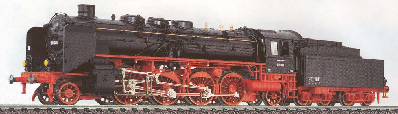

Based on the work you're putting into the 99 6001 2-6-2T, you could start with the Mikado and bash that into a class 39
That would get you two things:
- the 4 axle tender
- the large smoke deflectors, that make that such a period engine.
And the proportions are more standard gauge than narrow gauge.
http://www.osterthun.com/2b.models20-39/pics20-39/39.0~DR.jpg
