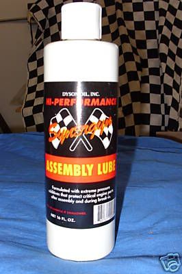

I have been useing synergyn assembly lube on things that need to conduct and so far have liked it .....
. it coats well does not attact plastic and does not stop conduction and does not run away
Where do find the assemdly lube? Thanks for the information
Scott, does it have moly in it?
And, I believe you, but how did you find out it does not attack plastic?
I got mine at the local speed shop ...... but they are on line too I think
no moly ....I hate moly I have seen it tear up high load heavy equipment ( I am a machinist by trade )
some of my oil tests where by trial and error ........
I did all the repairs for our local bio-park railroad for years and I was looking for ways to cut down the amount of work I had to do and one big way was to find some oil and grease that would stay put and hold up becouse I could not get the guys that run the trains to do much in the way of maintenance .........
when picking I would first start by puting a very thin strip of cheap styrene into the oil or grease and see if it would mess it up in a week or month or year if not then I would try it ........
most oils that I found would oil a bearing just fine but coat the electrical pickup as a electrical insulator and the loco would have power pickup problems .... this did not happen right away but took some run time to make the pickup not work
this lube did not and the power pickup got better with the lube then none at all so I started using it all the time and things went very well ........
the grease I like only on gears as it will work its way up a gear stack if put at the bottom and will not melt away in heat ....... sometimes here it van get to 110 degrees outside and I am sure that in the gearbox it was more like 140 and a lot of hobby grease would just melt and run away from the bearings ....... this stuff would still be there when I got the loco back on the next round ......... so I started telling the local club and others tryed it and as far as I know there has been no down side ....... most of the bio park locos would get 10000 to 15000 hours in there life .........
and I do agree that a dry lube would be better but none that I have tryed work long enough for me ........
I have also found that a lot of the oils put on locos from china do not help the conduction of the power pickup and has to be cleaned off .........
and that black stuff that makes the wheels look great also does not conduct well ..... so you need to use a bright boy and clean it off the tread and back of the wheel if it has wipers ......
I just did a speeder from usa ( the old k-line one ) and it went from not running at all out of the box to running great with just this oil grease and thaking the black off the wheel where the pickups ride ......
I just got a bottle of the synergen assembly lube and it seems like good stuff. It's thick and slippery and doesn't seem like it will run off with heat. It's almost like a gel
