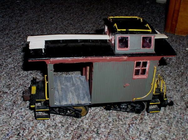

I was looking around upstairs the other day and ran across my Bachmann bobber caboose. it is a nice caboose but it tends to drag on curves, so I decided to add a pair of trucks to it. Once it was on the bench and taken apart I decided that it would make a nice little drovers caboose for my logging line. The results can be seen below. First I took off the cupola and modified the side windows. Then I decided to move the cupola to the back of the car.
so the roof had to be cut to accomodate it
then the cupola was moved back and the remaining roof piece was put in its place
then I marked where the side doors would be and started cutting
the results can be seen below
then the side doors were constructed using coffee stir sticks
then the door tracks and other details were applied
here it is painted and lettered
and with a little weathering and detailing
There is still a little detailing and cluttering to be done and couplers to be added. I will try to get the finished pictures up this weekend. Now I just have to build an engine to pull it!

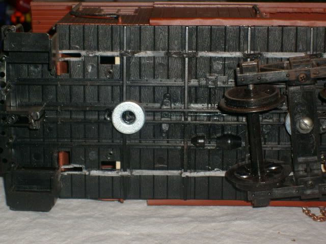

What did you use for trucks?
and how did you install them?

Dan, once the original journals were cut of I glued a stack of washers to the frame and drilled a hole and just screwed the trucks to them. The trucks are from a USA Trains work car, but they are the same as Bachmann and LGB. I was going to use some Arist-Craft delton freight trucks but the wheelbase is to long and will not fit between the original steps. Below are some pictures of how it was done.

I converted a 2 axle LGB toyrtain caboose like that, I used a shaped bolster of 1/4 sq. strip of basswood glued flat under the body and then used the same washer technique glued down for the truck to rest on.

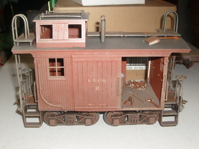

Great looking cabooses Bill! Here are a few more pictures with the link & pin couplers installed and some more clutter, Now its on to some interior details.
