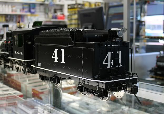

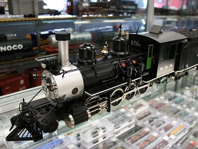

Hello all Im new to the forum and large scale. I'm no stranger to model railroading or kitbashing but im now getting into 1.20:3 a little. Im buying the accucraft c-19 RGS 41. I need some help on getting detail parts and help with some repainting. For the amount of money im paying for this locomotive im a lil surprised at what its missing.Iv already bought some detail parts from ozark and trackside details. But I still need a hydrostatic lubricator,I want to change the water injectors and despite having air pumps it has no brake valves(G6). I plan on modeling the locomotive as it was during 1941-1945. This means Im going to need to reletter it. anyone ever repaint or reletter an accucraft engine?

Well Tom thanks for the reference to DJB engineering. Although I can tell you right now that Accucraft didn't model 41 after the way she is today at knotts. We have her painted as she was in WWII.The way I want my model to be. The paint job accucraft put on her is the 1930s style. And are sunrise herald is an HO scale decal scaled up to a full size vinyl sticker.
52 Posts
Oh Tom I also forgot to mention that you are right about the backup light on the tender 41 never had one. Accucraft just used 340s tender and never botherd to take it off. The model accucraft has made is correct for its pre war look. although mine was sent back to have the sand dome replaced, because all the preduction models this time around had fluted sand domes. And as you can see from my above pic she has a round dome. Gary aren't 346s domes from when the C&S rolled her over?

Gary you are right the tenders are different 346 being a flared side and 340, and 41 are straight side. Accucraft based there model after 346. For 340, and 41 they changed the domes and cab and made a model of 340s old tender. And put it behind both 340,and 41. Thats why the RGS 41 has a backup light when it shouldn't. FYI 340s old tender is now the 318s tender, witch is currently hooked up to 346 at the museum in Golden. 346s new tender is still being built in Strasburg. And furthermore 318s old tender is behind 340 today at knotts. And thats where I'm off to now or ill be late for work! 340 can't run without an engineer!/DesktopModules/NTForums/themes/mls/emoticons/whistling.gif" border=0>

My customer relationship with Accucraft dates back close their inception. One thing I have learned over these years is that any generalized statement made about them or their models will instantly be proven to be untrue. The following link is an example as my new RGS 41 that has the correct rounded domes.
http://www.flickr.com/photos/edhume3/2411252553/in/set-72157603812083056/
I would totally agree that you have an understandable right to not be satisfied with yours being delivered with fluted domes. As you will find, Accucraft provides excellent after market support correcting all the peculiar factory mistakes.
A word of caution about sending your entire engine back to Accucraft. Accucraft most definitely honors their guarantee but in many cases instead of fixing what is wrong with yours and returning, they simply send you a new engine. This is good in that you do not have to wait for their backlog in there service department. This can be not so good in that each engine is hand made and the engine you get back might have a totally new set of peculiar detail issues, although seldom as significant as yours.
If you look closely at my engine for example, you will note that the front cab doors are hinged on the wrong side (one back door also) and for some very odd reason, my cab side are in-stepped instead of having a flush cab side. Obviously I got the wrong cab for RGS 41 combined with a totally unique assembly error. I have already fixed the doors and will fix the cab side before I paint. For me this is much easier that even boxing it up to send back. Alternatively, all I really had to do is call and I would have had a correct cab sent to me in the mail.

I also now that Accucraft is going to repair my engine not just replace it. My dealer is very close to the reps at accucraft. So far they said I was the only one who called and complained about the defects. I also pointed out the cab doors. (accucraft aslo said that the cab doors were wrong on the last run of RGS 41.) The front cab doors are wrong(technically thats 346s cab when she was rebuilt by the C&S after the roll over the front cab doors opened out just as they do today.) the rear cab doors should both open to the left side of the loco. This was done so the engineer could exit the cab with out a door in his face, and on the firemans side this meant the door opened out so there was no door in his way when shoveling. At knotts when we rebuilt the cabs we made both the rear boors open in and they stay against the back of the cab so they are out of the way during operation. And the fluted sand domes only got put on the sparky versions of 41. It was kinda funny it looked alot like RGS 40.

Well my c-19 finally came back from Accucraft, and Im very happy! My thanks go to my LHS, accucraft, and Cliff for making my 41 better. And putting up with me!
Now she has the correct sand dome and the front cab doors open into the boiler not away from.Now for the fun of some re lettering, more details, and a good weathering job.
That backup light has got to go, and the sunrise herald is going on!
