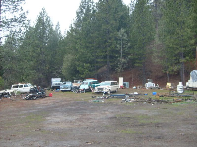

I've decided against our little orchard. Instead I'm kinda thinking about the south and west yards. Here's some shots of them:
The west yard:

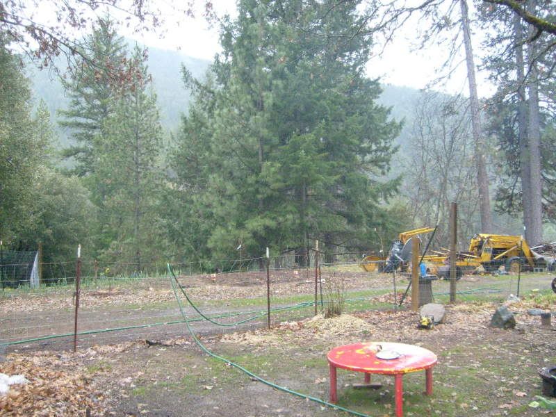

The south yard:

My first thought, somewhat tongue-in-cheek, is a layout over and around the old studebakers (those are studebaker wagons aren't they?). This could be a "Land of the little people" vs "Land of the Giants" kind of thing.
I know sounds kind of wacky but your RR would be close to eye-level. You wouldn't need to worry as much about leaves, crud, etc. on the track.

Interesting idea Bill, but no. The cars will all be moved out of that area. Even if I don't use it for the trains, it will be used as a garden. Yes, those are Studebaker wagons. One is a '63 Daytona just sold and bound for upstate New York, and the other is my wagon, a '56 Parkview. My roomate's '50 Plymouth can be seen in the photo also.
I've been thinking along the line of an elevated railway. There's so much stone around here I thought it would be a good medium for the walls of an elevated garden for the railway. Soil, on the other hand, is not so common a commodity around here. So, not only will I have to, literally, create it, but also fill to a depth of from one to three feet. A considerable challenge to be sure.

use the southyard.
some of your rolling stock is pretty long. so you should make the curves very wide.
5,635 Posts
Definitely go with the souh yard. You will be able to use broad curves for the long heavy weight pass cars. Looks like a challenge for sure. Later RJD

The general response has been pro that big flat South yard, (wouldn't we all like a space as big as that - I'm in a condo!) However, one of the issues to consider is biting off more than you can chew.
If you are starting from scratch, it is sometimes better to start small and expand later, as you get experience. It's very discouraging to be always building the base and laying endless track without running any trains. (Ask me how I know..)
The elevated track doesn't have to be all that high. Mine was 18" above grade, as that happened to be the height of the flowerbed. I'd suggest moving some rocks to make the outline of a raised garden, and then fill it with smaller rocks - you don't need 3' of soil. Just fill with soil when you have the rocks in place. Plants in your area must be used to rocky soil!
One interesting possibility, as you have a long side, is a 'dogbone' layout:
Basically an oval with the sides squashed together, it lets you have a center section that looks like double track mainline. You could have a loop at each end of the parking area and a long gently curved center section. You can get running by making one loop first and connecting the two sides in a circle.

I don't know if you folks can see it, there's a rather steep hill behind the south yard. It affords me the option of putting at least part of the layout up against there. this would save me buildiing at least one side of the garden wall. Nearly waist height is practically necessary. See, I've got bad knees and kneeling for any length of time is... uncomfortable, to say the least. Maybe two feet or so...
Course, building against the hill has it's inherent problems as well. Such as the trees. There's about nine of them there. Six at least would have to come out, not that we have a shortage of them here...
