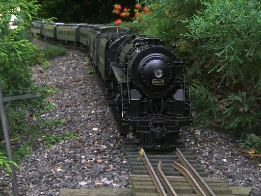

I would go for the Aristo heavyweights. A lot of the NYC Hudsons were streamlined in later years when they would have been pulling aluminum cars.

Brian... you bad bad boy... Illegal hotlinking again.... you should be so ashamed..

Do you not see the same graphic we see for the second image of you post? We see a black rectange with red and yellow letter saying "Hotlining detected...."

Anyway I agree with Brian. The heavyweights would be the best option unless you are modeling the very end of steam when the Century was more abbreviated and had a mix of streamline cars.

Posted By Semper Vaporo on 08/13/2008 9:29 PM
Do you not see the same graphic we see for the second image of you post? We see a black rectangle with red and yellow letter saying "Hotlinking detected...."
No, I don't see that at all. Maybe Firefox is blocking it. Just an image from google image search.

Is that a USA Hudson? Why does it look like it is shorter than the passenger cars behind?

Posted By altterrain on 08/14/2008 5:01 AM
I use IE-7.
This is what some of us are seeing in your second image.
I had to reduce the image 50% in size and to 16 colors to get the file size down to less than 60KB so I could post it using the "Message Attachments" so this copy is very poor and hard to read. But this is what at least some of us are seeing.
Apparently the second image is from a web site with either the name of: http://www.toytrains.com (Railroading) or http://www.toytrains.com (Roses & Garden) and the owner of that site is concerned about people using his bandwidth by linking images from his site to other sites and to attempt to stop it, his system replaces the image with the text graphic complaining about it.

Thanks Charles, image replaced. Don't want to take dough out of someone else's pocket.

Good eye, Mark. I back tracked the image and its an Aster model like this one on eBay - http://cgi.ebay.com/ws/eBayISAPI.dll?ViewItem&item=160269418391

Cool. I can't see the plume, but I would guess that is a live steam Aster, based on the brass thing sticking up in the tender. Nice locomotives, I saw one that had been coverted to burn coal. The smell of the burning coal was intoxicating!
