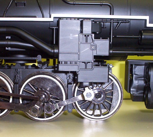

I used my flame to heat a screw driver. Then I was able to loosen the screw and turn the wheel back to where it's supposed to be. That red locktite REALLY holds.
Wonder if I got it right.
I think G scale junction has treated you very well. Call Aristo at 973-351-9800 and explain your situation. They'll get it taken care of for you.

Yeah I agree, this isn't normal. Aristocraft transfers power through inside gear boxes and not through the connecting rods so it should run super smooth. The binding is most likely caused by drivers being out of quarter as has been said and this was something I had to adjust on some of my axles.

Well, I was gone most of the day today, but when I came back, I set up a large oval on my back driveway which is 70X12 ft. After about an hour of running at flat out, it's smoothed out quite a bit, but still isn't perfect. I'll try lubing the axles tomorrow, I've packed it in for the night. I'll go take some pictures, and maybe one of you can be better at seeing if the drivers are out of quarter or not. And to answer Greg, this is a DIFFERENT mallet, I requested a replacement, not a repair.

If you have time, take and put the engine on it's side and hand test each driver to see if any can be fairly easily turned on the axle. If you find one or more then I would either send it back or work on securing it.
If for some reason you decided to try and loosen the axle screw, DO NOT attempt without heading the tip of a screwdriver with a torch first. You will most likely snap the screw head off the axle and you will be faced with an even larger task of dismantling the motorblock to replace the axle end. (ask me how I know...) Don't put too much torque on the screw.

None of the drivers are capable of being moved more than the absolute tiniest amount, and I'm quite certain that the drivers are quartered correctly. I'm suspecting gearbox trouble because I can hear gear grinding when the loco is running at slow speed. I tried pushing on the drivers fairly firmly and they didn't move hardly at all, no more than any other loco I've had. I have heard about the axle screws, so I left those alone, I don't have anything to heat the screwdriver with. I'm calling Aristo on Monday and I'll see what they can do for me, I'd love it if they could send me a new rear mechanism, as I'm pretty certain the front one is fine, and I'm really not in the mood to wait a month and a half while Aristo tries to repair my engine.

Well, after running it some, it looks like the back right driver on the front mechanism is out of quarter. What puzzles me is this is the FRONT mechanism, the one that is not giving me trouble, at least as far as I can tell.

If your capable of removing the rear brick then I would just send that back for repairs if this is the one making all the noise. Thats what I did with mine. Its sad that you have had this problem but believe me AC will stand behind it and make it right. Sounds like you have that little guy on your shoulder as I do at times and known as Mr Murry.
