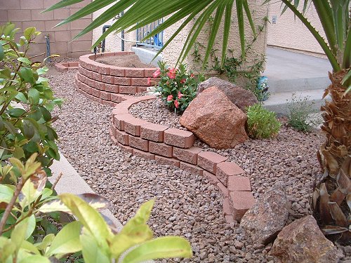

I just finished this little project in my front yard:
The blocks make a fine little retaining wall for plants, shrubs, flowers, etc...and are only 9-inches wide. Home Depot classifies them as "Edging" rather than "Retaining," but whatever they are supposed to be, I like them stacked! I used Liquid Nails in my caulking gun to glue them in place & prevent shifting/moving.
Cheap, not too heavy, easy to work with, and good looks. To cut them I broke out my tile wet saw (another Home Depot "cheapie" 12 years old and going strong), made a 1/2-inch cut all the way round the brick, then broke out an old chisel to complete the cut (just a couple of whacks from my rock hammer on the chisel & the bricks split right down the cut line from the tile saw). Works perfect every time!
